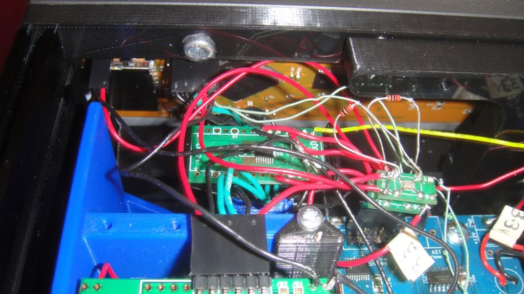

Finally got restarted on the DAC build yesterday after the holiday break and oh boy were we rusty. could not remember where we were at last year!!
Anyway eventually got on track and managed to listen to the lasted version DAC with high quality resistors bot with and without buffer stages.
All were immediately in favor of going with the buffer stages as the sound was really sweet and tight so that was a slam dunk.
The DAC sounded amazing so much so that we struggled to pull ourselves away from just listening to lots of music.
For the front panel we are working out whether it is worth the expense of going with a machined aluminium and anodised panel at considerable expense, a machined polymer composite at an unknown price just yet or just printing front panels and hand finish with painted finish.
We have a good idea of the final layout now and Tony preped some Traffos so we could get one set in the case.
We dropped some of the boards on printed shelving just to get an idea of cable runs so we are close to final assembly work in the coming weeks.
Some pics of a possible final layout below:

Its been a while since we posted an update on the build so here goes.
I had the great pleasure to bring the first test build home with me 2 weeks ago and i have to say the sound performance has been a revelation.
Its easily the best DAC i have ever heard and i expect there will be more glowing reports in the coming months once we finish off all the final touches and get the rest of the units in everyone's hands.
For now I will post some pictures of the test DAC before final finishing.
