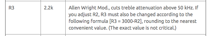

nige2000 wrote: The diagram from the website seems to suggest that r2 isn't part of the Allen right MOD and changing its value doesn't affect this adjustment
Yds, but check further down on the page. If you change the gain with R2 you need a small adjustment to R3.
