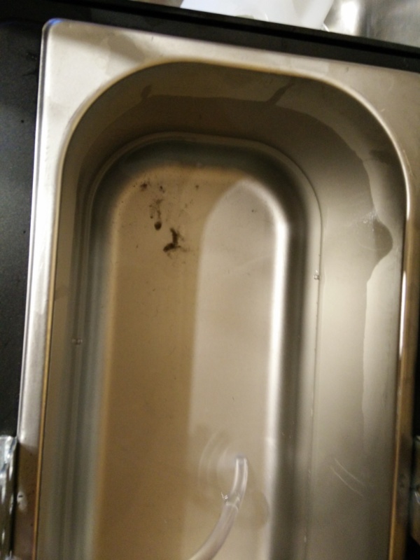

Indeed, it's not unlike a jobo roller! I always thought the ultrasonic method might work - I use such baths in work quite a bit so knew the potential. Just in case there was any doubt see the pic below of the crud in the tank after washing 21 records most of which had already been washed on a wet/dry system!

Fran - you are a legend!!! :-)
