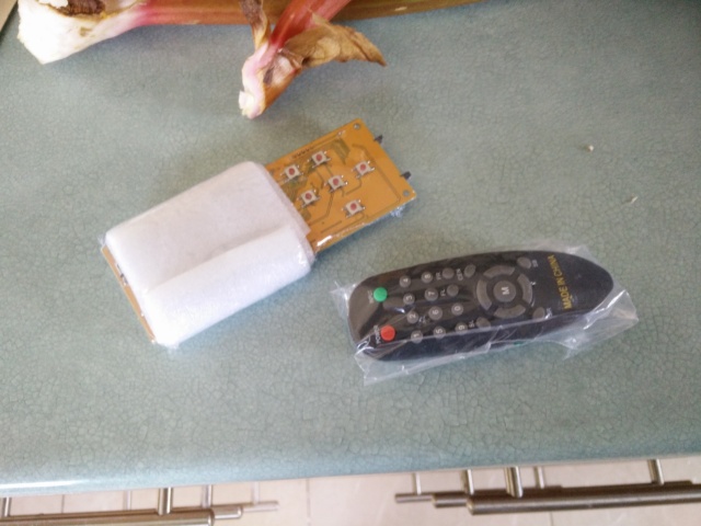

randytsuch
Posts: 395
Post by randytsuch »
nige2000 wrote: Thu Apr 19, 2018 2:19 pm The switches on the front panel are 3.3v input
Would a ss signal relay work better?
Maybe we don't need any isolation?
I'm just figuring the ESP's are probably noisy, so it would be better to isolate. But maybe we don't? No idea if the noise will come though from the ESP.
But I already have the opto's, so it pretty easy for me to add them. So I prefer to do it, and not worry about it later lol.
The GPIO pins on an ESP can source 12ma and sink 20ma.
If required, you can also add a gpio expander chip that can handle higher current
I've used PCF8574's and they can sink 50ma.
So you can use any relay, ssr or opto you want as long as sinking 20ma will drive it closed.
I was having trouble finding relays that would work with 20ma at 3v. They want closer to 50ma at 3v.
I just was looking at someone's SSR, but it was basically same as an opto.
Randy
Mine arrived today, but I won't get to play with it for at a week....
nige2000
Posts: 4253
Location: meath
Post by nige2000 »
Ah you got a remote, that be handy for a while till the ui is finished
