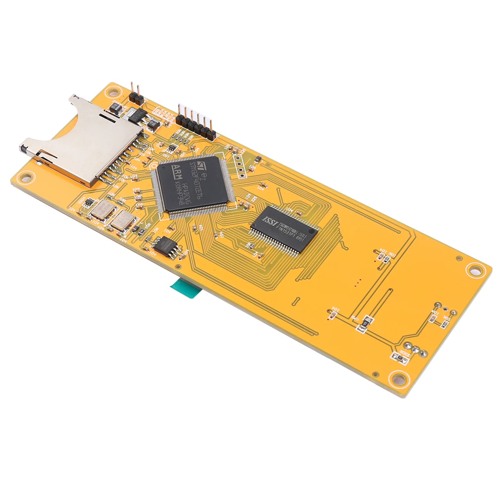

Just to progress this somewhat - how about doing a group effort to trace the STM pins & develop the schematic for this board?
There are 4 sides to the STM chip & 4 of us could take one side each & trace where the pins of that side connect to
Anyone with one of these SD card players want to volunteer to trace a side?
I'll do the side at the top of the photo - the one nearest the I2S out pins
www.Ciunas.biz

I'll take the next side around John - underneath where it says "ARM" in the image above.

Fran wrote: Wed May 23, 2018 10:44 pm I'll take the next side around John - underneath where it says "ARM" in the image above.
I got my flashair card yesterday, and after some figuring out (I can't believe how poor the interface is on this from the company) I have it working for transferring files over tonight. So as proof of concept, it works. Files are fairly fast over the wifi here, and very fast when the files are in the slot on the laptop. Unfortunately, I have some bug in my system here - I can't get it to play anything with a bit rate over 16. It will play both sample rate families so I don't think its the clocks. And it played hi res fine off Nigels card in Tonys. This has yet to be investigated!!
Cool, Fran - we'll put it all together from each person's mapped connections

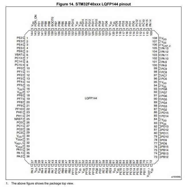

Best to use these chip pinouts for this 144 pin STMF407 chip - diagram from the datasheet
Note: pin 1 is marked with the dot on the chip so the corner nearest the SD card - so you are mapping pin 1 to pin 36 - I'm mapping pin 104 to 144
