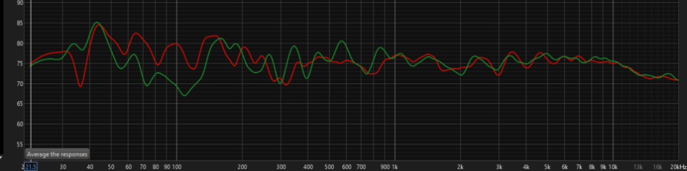

Treatment fixed echo (RT60 around 0.3s), but can't fix room mode at 42hz (room is 4x5m, and 42hz is that 4m depth) so had to do a small trick - close bass reflex ports of the speakers to have bigger roll off of low frequencies (makes speaker sealed box), and then use a subwoofer at the place where it doesn't trigger that room mode but compensates for a small lack of bass freqs.
Think i settled with the treatment so far (2 panels behind speakers, 2 on ceiling, 3 behind listening place), and will be experimenting with different speakers maybe, just to see if smaller/different speakers don't trigger that room mode that much.

True, peak was at least 10-15db, specially because thats also a tuning frequency of the port.
But, speaker works well with ports closed, seems to be designed that way so it can work in the smaller rooms.
Here's stereophile measurements (red line is with ports closed):
(from https://www.stereophile.com/content/q-a ... asurements)
And my measurements, maybe not the most recent one, but kinda close (L+R speaker, ports closed, KC62 sub in the corner):
