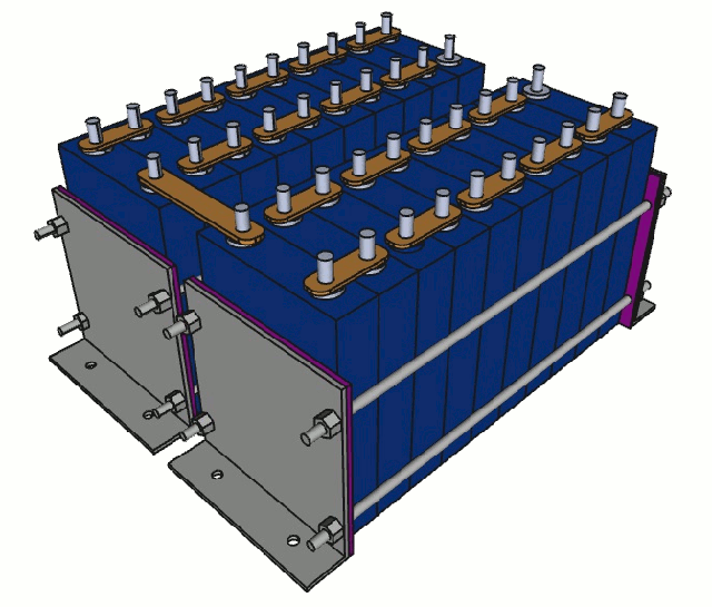

I was thinking about something like this. The ingredients are:
* L-shaped aluminium bar: 80x20mm, 2mm thick
* M3 threaded rod
* silicon mat
* M3 nuts
remember to allow room for expansion!! We don't want a samsung phone issue!!
Maybe use some mouse mat between every other battery?

Aren't these cells in aluminium boxes with plastic wrap already?
nige2000
Posts: 4253
Location: meath
Post by nige2000 »
yea think so
all in alu casing
if in fear, a spring on the threaded bar would allow expansion
wont really be working hard enough to be an issue imo
its just vast... no.... ludicrous reserves of low impedance power
the actual power consumption isnt much to worry bout
