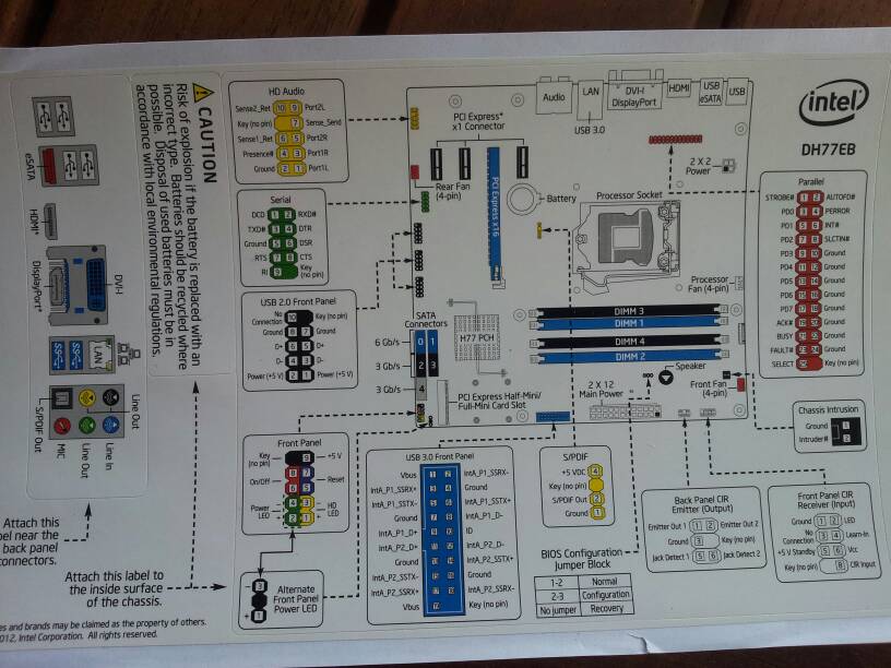

sima66 wrote:
nige2000 wrote:well its the usb2 ports that are the noisiest so if you dont need any of them you could turn them off
I use only 2 USB ports and the most "handy"(close to the corner) are usb 2.0, but that still does not matter.
Problem is that in the diagram it does not say which number is what USB port!
It only shows 14 ports in MoBo and does not say which one is 2.0 or 3.0, or the position! :(
think you can get a usb3 header cable for the fc5 change them usb2 slots into usb3
might be worth investigating
other than that it would likely be trial and error unless pearse knows
I did have pictures of the bios settings on the Intel board but cannot find them no matter where I look!
It was a case of trial and error to track them down but from memory the 1 to 4 are those close to the corner if that is any help.

Thanks, Pearse!
I have this diagram if this might help better! :((
