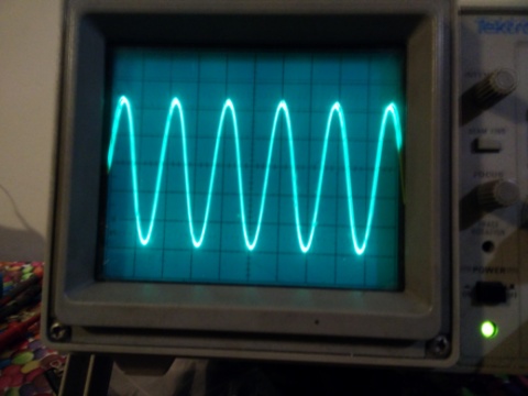

- 1152018224430.jpg (43.78 KiB) Viewed 1751 times
right although the video i took isnt clear
i got my trios to clip at 20 and 50 hz at 18v peak to peak
their 4 ohm speakers
still even at that its plenty loud just below that without the possibility of a below 50hz clip
above 6ohm speakers will be a breeze to it
this was 20-1k hz
little did i know that with the setting up i accidentally disconnected the bass driver
thats why there was no clipping up to 60v pp
