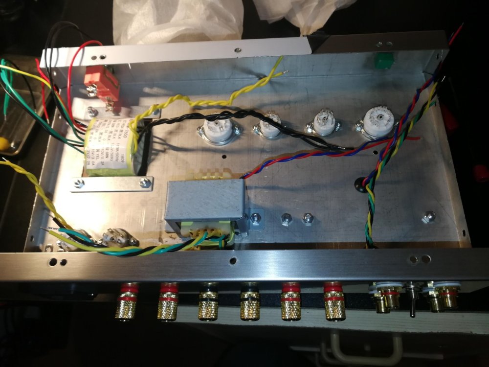

Some progress...
Rocker
Posts: 567
Re: New DIY Tube Amplifier Project
Post by Rocker »
Nice work.
One small point: the heater supply is AC and the cabling needs to be as far away as possible to the signal cables. In your pic above, I would get those 'blue' twisted cables into the angle at the back of the chassis and keep them there with a spot of glue. The gain structure might be different for a guitar amp but most guitar amps, the point to point wired ones, keep the heater wiring well out of the way.
Neat work, looking forward to the build.

Rocker wrote:Nice work.
That's a fair point. Was thinking about it but at the time I didn't have enough wire length to do it this way.
I'll try the amp like this (should be ok) and if a hum, I'll rewire the heater [emoji39]
