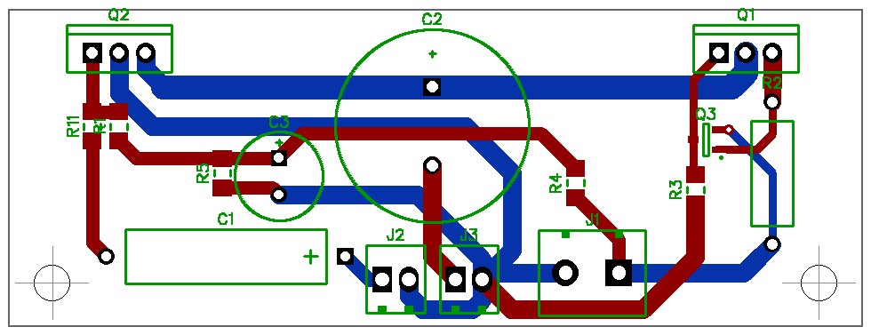

next attempt, this one is better for grounds and power routing, I think.

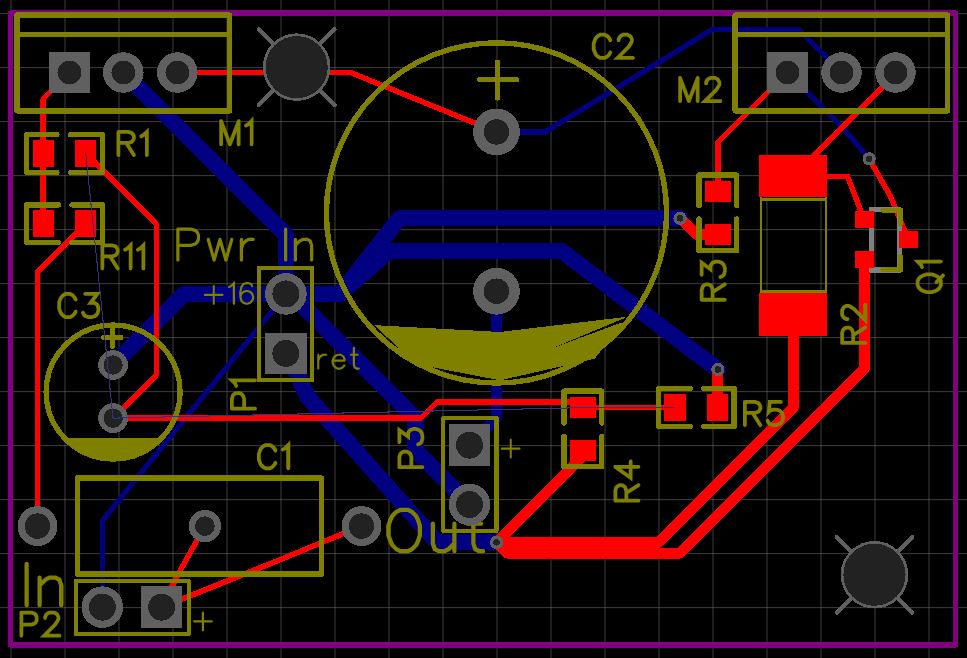

Randy, here's just an idea:
randytsuch
Posts: 395
Post by randytsuch »
Thanks for that frd.
Your layout is much cleaner than mine, will steal much of what you did.

that looks good to me
learning pcb design should be on my agenda too
