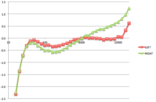

First up, the Sanyo
. Here, as a function of frequency, I plot the difference in decibels between the Sanyo gain and the RIAA response, for a 4mv input signal. All curves are normalised to the response at 1kHz. Hardly a stellar performance, with deviations of one to two dB at the highest and lowest frequencies. More to the point are the noise numbers. The data sheet for the Sanyo advertises a signal to noise of 95dB - but that's through the line-level input. They are curiously silent about the phono performance. I can see why. Referenced to the output of a 4mv signal at 1kHz, I measured the unweighted noise between 22Hz and 22kHz to be 31dB, while the A-weighted noise (corresponding more closely to what the ear is sensitive to) is 55dB.

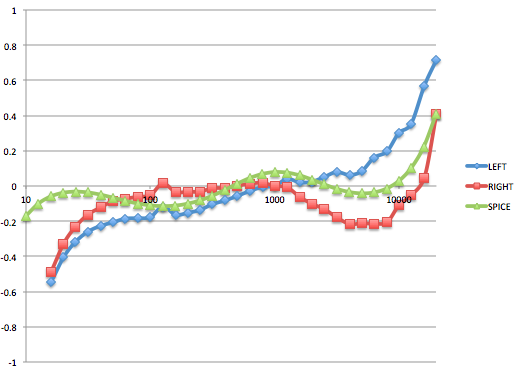

Now, Frydryck's DIY based on http://phonoclone.com/diy-pho5.html. The components are mounted on a PCB bought from the website with some very nice upgraded capacitors. Frydryck mounted the power supply in a separate box and it's fully dual mono: toroidal transformers with Schottky diodes bypassed with capacitors. The build quality is superb. Here's the RIAA response (note I had to change the scale on the y-axis!)
. Wow! Less than 0.2dB across most of the range and perfect matching between left and right channels. I also did a SPICE simulation for the circuit and you can see that the deviation from the RIAA curve at the highest frequencies is due to the circuit design. The signal-to-noise values are 44dB unweighted and 70dB A-weighted. I think that's well below the intrinsic noise of most turntables.

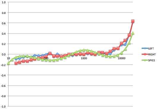

So finally to my build. This just uses what I had lying around: so a wall-wart transformer with the rectification, smoothing and regulation in the same box as the phono circuit, which is just soldered on a breadboard. The capacitors are only ceramics. Here's the RIAA response.
. There's a mismatch of 0.4dB between the channels at high frequencies while the signal-to-noise values are 42dB unweighted and 68dB weighted. So, not quite as good as Frydrycks but a heluva lot better than the old Sanyo. There are some obvious improvements I can do - making a proper PCB and possibly upgrading the capacitors, but I suspect I'm already below the turntable noise floor, and more importantly, the vinyl I'm spinning is sounding wonderful. I guess some of the hype is right after all.

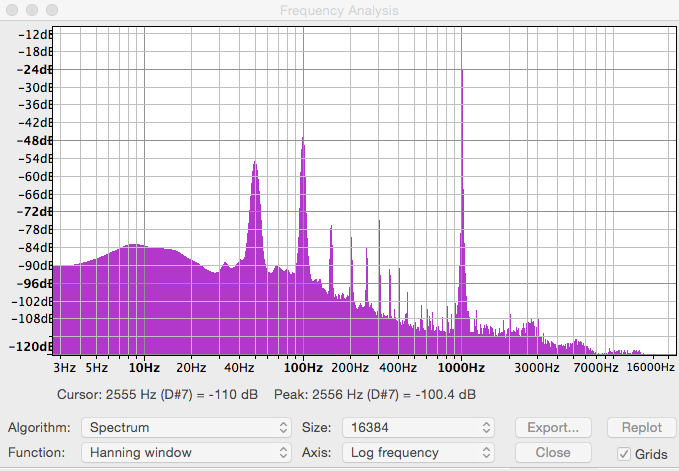

That are very nice measurements. Would you be able to measure the THD of the circuits at 1Khz?

frd1996 wrote:That are very nice measurements. Would you be able to measure the THD of the circuits at 1Khz?
The measurements were performed by feeding the phono amplifier with a 1kHz signal. The output was analysed using a notch filter to remove the source, so this gives the total noise. To get the harmonic distortion from a 1kHz signal would require scanning the output as a function of frequency, and the Audio Precision kit didn't have this feature.
What I tried doing, was to send the amplifier output back into my computer and taking the Fourier Transform. The result is in the plot. Major caveats: the ADC in the computer is probably rather poor, and the power supply spuria are almost certainly due to the computer and not the amp. I can't see any harmonics on the 1kHz signal, but this is not a precise result.
