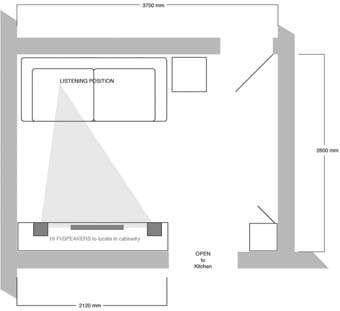

I am contemplating moving my system into a very small room that would allow me to enjoy extended listening on a regular basis.
3 lads getting bigger, piano in "my room", frequent interruptions, etc., etc. ....
Not decided yet but it seems to me that this might be our best solution.
Room measures 3700 mm X 2800 mm. Listening across the shortest distance.
My problem is that it's a small space with some furniture/cabinets that run floor to ceiling and won't be removed/replaced.
I can alter these to suit hi fi and speakers.
Simple drawing attached to help illustrate situation.
Any suggestions for suitable loudspeakers ? Need to be small, emulate large floorstanders sound quality as much as possible, and cost no more than, say, €1,750.00
Synergistic with 300B integrated amp [i.e. low output].
Size matters [!] but appearance not an issue.
Must perform within the confines of the cabinets - rear ports are probably out ?
And there's a TV to stay between them !!!!!
This isn't definite, but as I say it could solve problems ahead.
Any help much appreciated.

It's a tricky one, isn't it. There's no doubt that it can be difficult to get really good sounds in such a small room (believe me, I know all about it) but you might get lucky. Actually, the various cabinets and even the TV will probably help, because what you want to do is break up the reflected soundwaves as much as possible, and any kind of large-scale "stuff" helps in this regard.
Matching will of course be tricky. I was originally going to suggest some (older?) Sonus Fabers, as they work very well in my fairly small living room with a valve amp and I'm quite taken with their sheer gorgeousness, but I really don't think 300B level output would be enough to drive most of them. Then I was going to suggest getting your hands on some Living Voice speakers, but I think that might be floorstanding only. Contrary to popular belief, I think the vast majority of small speakers require MORE power rather than less, but I know there are bits and bobs of esoterica that might just work. Certainly I'd agree that infinite baffle, or at the very least front-ported, is the way to go. You *could* try the PMC DB-1s, as some have reported good results with low-powered valves.
Before you do anything, how does the room cope with the clap test? Wanter round clapping and listen out for hollow echoes and/or a kind of ringing sound.

Hi - Have you thought about the possibility of using a sub to compliment the small speakers ,
If you have being used to Floor standers you will struggle to match that sort of bass response from stand mounts . You should try A good pair of Mini Monitors and a dedicated Sub also . You might be surprised at what you hear ! Cheers John .

Is there any way that you could arrange the speakers to fire diagonally across the room - each speaker 'backs' on to a different wall and you are seated facing a corner. Sorry for the terrible description, a sketch would simplify this. There is an article on this idea somewhere on the web, it might be worth Googling for it.
